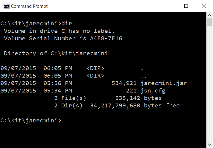

To start the application in Windows, open a command prompt and go to the folder where jarecmini.jar and jsn.cfg file was placed.
Run the command java –jar jarecmini.jar:

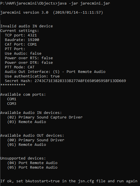

You will be displayed a list of available COM ports, audio in and audio out devices. Please note the number before the name of the audio device you want to use (for both in and out).

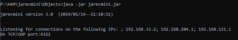

Edit the configuration file (jsn.cfg) according to your needs. Keep bAutoStart=false and run again to check that you selected the right parameters. When ready, change bAutoStart=true and run again. The application will go to listening mode:

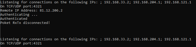

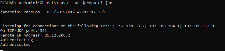

When you start a connection from PocketRxTx the remote IP address will be displayed, the audio channel will be started (if activated) and login authentication performed (if selected).
You can now use the connection. If you stop PocketRxTx, then jarecmini will go back to listening mode.
