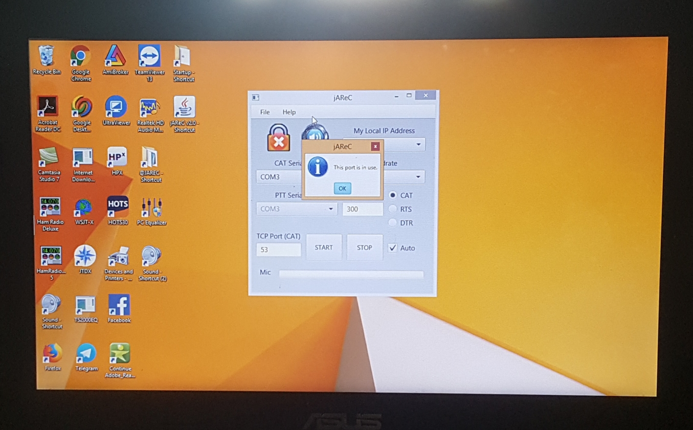

Previously everything is fine when I use Pro V2.0 and latest Java 8u181, I enjoyed your apps more than view months until something happened around 2 months ago.
It is happened without any changed in my computer since this computer stand by only for Jarec.
Now, I tried with new updated Java 1.8 and Jarec V3.05b, but the problem issue still comes up.
When computer in idle state it seemed computer tried to relaunch Jarec once again, unfortunately the running Jarec still active, so there is conflict using TCP port (CAT) as sawn in attached picture and the worst thing is the active Jarec can not be closed by normal instead of restarting computer.
Regards

Posts: 632
Re: A new experimental PRO version (3.0b) is now available for download
Post by yo3ggx » Wed Sep 12, 2018 3:46 pm
Hi Nuril,
Have you checked that in Control Panel > Devices the COM port does not have a yellow exclamation mark?
Looks like the COM port does not work as expected.
It may be too that another application is using the same port. COM port cannot be shared between applications.

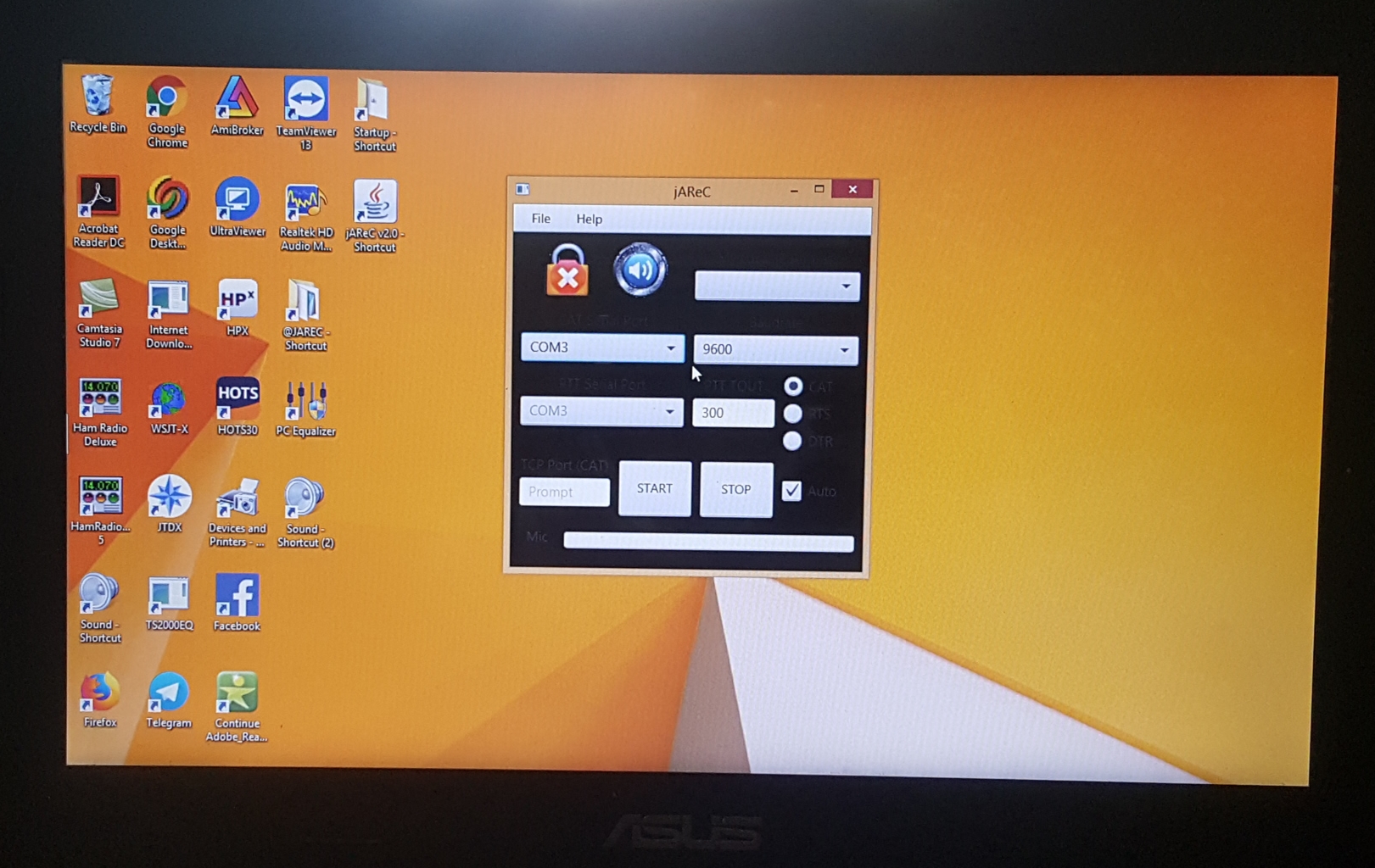

Post by YC1UTC » Thu Sep 13, 2018 3:51 am
I checked that COM port work fine.
The computer after restarted Jarec work fine, it is mean that COM port work fine too.
Even though problem issue comes up, I checked COM port no exclamation mark in device manager
I think the Port in this issue is mean TCP Port (CAT).
When I close dialog box of "The port is in use", Jarec display color become black and TCP Port become blank which normally I use 53.
If I try to reenter with 53, the dialog box "The Port is in use" will come again.
Hope this explanation give better description. Thanks.
73, Nuril YC1UTC
Posts: 632
Post by yo3ggx » Thu Sep 13, 2018 9:24 am
Hi Nuril,
It may be that when this happen, jAReC is crashing in the main thread (handling the GUI), but the CAT thread is still running. This will keep the port in listening mode.
You stated in a previous message "When computer in idle state it seemed computer tried to relaunch Jarec once again, unfortunately the running Jarec still active". Who is trying to relaunch jAReC? Currently this feature is not available in jAReC, but only trying to restart listening when connection with Pocket RxTx is dropped. Do you use any kind of script for this?
You may try to check if some java processes remains active with Process Explorer (a good replacement for Windows Task Manager). You can download it from here:
https://docs.microsoft.com/en-us/sysint ... s-explorer
