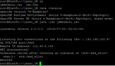

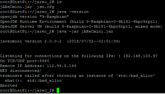

Hi Dan:
I test the new verion jarecmini.jar v2.0 on a raspberrypi 2B, and now it can working with a cheap USB soundcard, but the jarecmini.jar will crash when the client disconnect.

Post by yo3ggx » Mon Jul 02, 2018 1:38 pm
As I'm working hard now on version 3.0 for Pocket RxTx and jAReC, I will check this and fix the issue if something broken.
