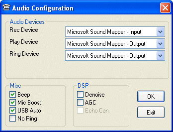

  • Audio configuration form

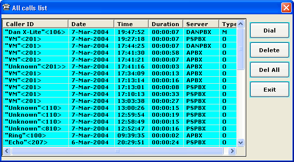

  • Calls List form

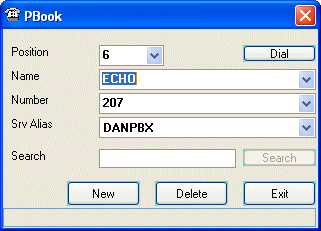

  • Phonebook form

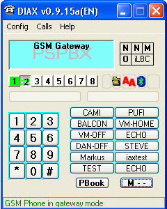

    Main application form

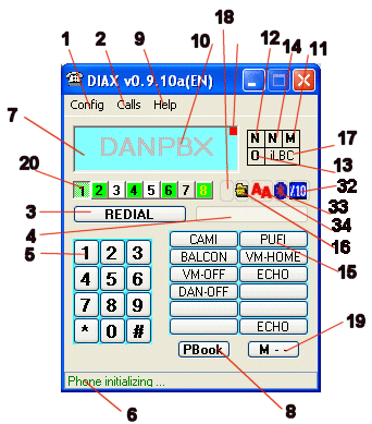

    The graphical interface is very intuitive. Moving the mouse pointer over different objects in the form, a small description is displayed related to the object functionality .
    A status bar is available too, in the lower part of the window. All the error messages and/or information are displayed in this status bar.
    The main window appearance depend on the phone status. The default is the first one. When you're in a call, the second is used in order to save space on the desktop. The Ring Volume adjustment is visible only when a call is received and the phone rings.
    Here is a short description of the used objects:

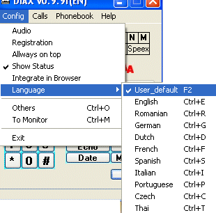

    (1) - Configuration menu. From here you can: configure audio devices, enter credentials for registration and/or dialing, set the windows to stay always on top, select language and/or activate status bar;
    (2) - Click here to select the type of the call list you want to display. You have the following options: outgoing, incoming, missed, rejected or all calls;
    (3,4) - Multifunction buttons: can have one of the following allocation :NONE_NONE, DIAL_DELETE, NONE_HANGUP, ANSWER_REJECT, HANGUP_SELECT, REDIAL_NONE. See the operation mode for more details;
    (5) - Numeric keypad. It is used to enter the number to dial, to send DTMF codes when in a call or to enter the extension you want the current call;
    (6) - Status bar. Here you can find the callback messages from the low level communication routine. You can disable it for normal operation;
    (7) - The multi-functional phone display. Here you can see the number you dial, the name and the Caller ID when you receive. First line is reserved for the name and the second one for the number in "<>" brackets. On the background, with semi-transparent foreground color the alias of the current used server is displayed;
    (8) - Click here to enter the phonebook;
    (9) - Click here to enter the Help menu, with the following options: Content (this file), CallMe (to call my home phone and leave me a message), DIAX Site (my web site containing  this application and ...others..), About (application version and copyright notices).
    (11) - This is the "Missed Calls" indicator. When no missed calls a black 'M' is displayed. When you have missed calls, the letter 'M' flashes. The tooltip displays the number of missed calls from the application startup or from the last access to the Missed Calls list. If you access the Missed Calls list even for a single time, the flash stops and the counter is reset. ;
    (12) - This is the 'New message(s)' indicator and always display the 'N' letter. When you have New voice message(s), the letter 'N' flashes. The tooltip displays the sum of new voice messages from all registered servers;
    (13) - This is the 'Old message(s)' indicator and always display the 'O' letter. When you have Old voice message(s), the letter 'O' flashes. The tooltip displays the sum of new voice messages from all registered servers;
    (14) - The ID of the selected call if any active. It can display 'N' (no active call), "1" if the first active call is selected or "2" if the second active call is selected;
    (15) - 12 direct access memory buttons. Used to directly access the phonebook records from the locations 1-12 and dial them using a single click;
    (16) - Application events activated (see operation here);
    (17) - The default audio codec (corresponding to the selected registration server) when idle or the currently used one during a call. This box flashes when the default codec is different than the currently used;
    (18) - Infrared events activated (not yet implemented);
    (19) - Click here if you want to dial a direct access memory entry (between 01-99), then the two digits of the entry position in the phonebook;
    (20) - These are the buttons corresponding to the 8 available registration servers. The button can be grayed for the non configured server positions, white for the configured server positions not requiring registration, red for the configured server positions requiring registration but not yet registered or green for the configured server positions already registered. You can directly select any of them by a single click (this become the default server). The default server button remains pressed and his alias is displayed with big letters on the phone display background. The tooltip displays the alias of the server, the number of new/old voice message(s) for each of them and the time (in seconds) from the last registration refresh;
    (21, 22) - Volume sliders for the audio input and output device currently selected in the audio configuration menu. ;
    (23) - Microphone level digital VU-meter; The indication goes to red if over modulated;
    Mute button. You can press it during a conversation if you want to mute your microphone. The correspondent VU-meter will disappear. Click again to restore the microphone sound;
    (24) - Speaker level digital VU-meter; the indication goes to red if over modulated;;
    (25) - The Monitoring ON status indicator. This indicator is flashing (red) when the monitoring is activated;
    (26) - Unattended transfer button (visible only during a call);
    (27) - Macro buttons to automatically dial DTMF tones during a call;
    (28) - Microphone MUTE button/indicator;
    (29) - Speaker MUTE button/indicator;
    (30) - Call timer (starts at the beginning of the call;
    (31) - Ring signal volume (when polyphonic ring is selected in audio configuration menu). This is visible only when phone rings;
    When this label is visible, the debug mode is activated. If green, then the debug log (diax.log) contain information;
    (32) - X10 events activated (see operation here);
    (33) - Bluetooth mode indicator;
    (34) - Auto answer mode indicator.

    You have the option to configure audio devices, set the registration and/or call credentials, make the main app window to stay on top, enable/disable Status Bar display, generate registry file to integrate DIAX in Internet Explorer, select language, configure the 6 customizable macro buttons, autoanswer definition, application definition, X10 devices settings, Bluetooth configuration, monitored events and to exit the application. You minimize in tray the application by clicking on the 'X' from the right up corner. To exit the application you need to pressing 'X' key when the main application window is active or to select Exit from the Configuration menu.

    You can select which call list to open: Outgoing, Incoming, Missed, Rejected or All calls.

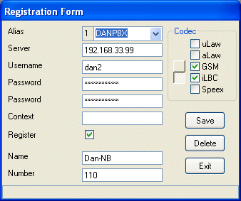

    Registration form
    Use this form to enter registration info used for your account on the Asterisk server and/or the credentials used to dial using numerical values. You can define up to 8 Asterisk servers. For each of them enter the credential used for registration/dialing.
    For each of the registration server you can select a default codec and the available ones for that server.
    You can select the default codec ONLY from the list of the available ones.
    Enter the username, password and the name (fully qualified domain name) or IP address of each Asterisk server. You can define a specific context for each server or to keep it blank.
    If not port is specified in the server field, then the default one (4569) is used. Use the following syntax:
    server:port, for example: 192.168.33.99:4560
    If you do not want to register with a specific Asterisk server, then uncheck the "Register" checkbox. This option, together with the credentials and the IP Address for each server will be stored in the configuration file. Each server has an index from 1 to 8 which can be directly selected from the corresponding list box.
    The small box from the left side of the server ALIAS displays the default registration/dial server index number. If you make any modification in the window, the 'OK' button changes to 'Save' in order to permit you to save the changes in the configuration file. If you exit the registration window by clicking on 'OK', the application restart the registration process for all the defined servers.
    You can delete any defined server by just clicking on 'Delete' button.
    You can set your own CallerID information (Name and Number) which will be used if the Asterisk server will accept this. This information is common for all registration servers.
    NOTE: The 'Alias' list box displays the defined servers. If you want to define a new one, select an empty index from the list and then fill the whole form and click on 'Save'. A possible shortcut is to right click on the corresponding registration server button in the main window to enter the registration menu automatically for that server. The same result is obtained if left clicking on the button of a non-defined server.
    Use this form to configure audio devices and options.
    You can select any available audio device as input, output or ring and more, you can select PC Speaker as ring device too. In this way you can use a headset on the soundcard and when someone ring you do not need to have the headset on your ears in order to hear the ring. Another option (used by me too) is to use an USB headset (in my case a wireless Bluetooth headset) as Record and Play device and the normal soundcard as Ring device.
    The Mic Boost option works only on selected soundcards. You may check it to see the results.
    USB Auto mode means that if you have one of the supported USB phone connected to the USB port before the application is started, that device is automatically configured for Rec, Play ands Ring device.
    You can select to mute the ring signal for incoming calls by checking 'No ring' checkbox.
    You can then hear the ring in the speakers, even if you play some MP3's in the same time, click on the headset switch (if Bluetooth) to connect audio and.... you're in the call. In a future release this operation will be automatically for a Bluetooth headset, like it is when you use it with your mobile phone (ring in headset too and click to answer).
    Some Digital Signal Processing options can be set from the DSP frame: De-noising filter, Auto Gain Control (AGC) and Echo cancellation (not available in this version). You can play with those options for best audio experience using DIAX.
    The key beep can be disabled from the same window. There is a mic boost option, if the soundcard permit this. The standard keypad beeps are now replaced by the corresponding DTMF tones.
    All those settings are saved in the configuration file.

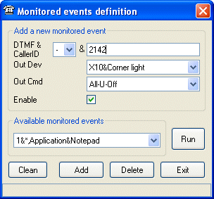

    To enable monitoring of calls and executing Application and/or X10 commands, check "Enable Mon".

    Calls List form
    You can choose to display any of the available call list: Outgoing, Incoming, Missed, Rejected or All calls.
    Here is presented the window for the All Calls list.
    The difference between the lists is just the last column, which is not displayed on the other type of lists.
    From this window you have some possible options:
    Delete a selected entry, delete all entries or dial a selected entry. You can select multiple entries using CTRL key when clicking on a row. If multiple items are selected, the Dial function applies to the first one selected only. After clicking on Dial, the full CallerID information is transferred on the phone display, the server automatically selected and the Call List form closed. You can then change the server (if you want) and then click on Dial in the main window.
    For each call you have the following information:
    If you initiate a call and then hangup before the other party answer, this type of call is not registered in any type of call list
    The calls are ordered as the last placed/received/missed call is placed first in the list. You can choose to order after any column you want by clicking on the column header.
    Click on 'Exit' to return to the main application window without transferring the selected call information to the phone display.

    Phonebook form
    You can directly access the Phonebook form by clicking on the PBook button in the main window.
    They are 4 combo boxes: Position (the position of the entry in the phonebook), Name (the name associated with this position), Number (phone number or full IAX address associated with this position) and Srv Alias (the server used to dial that specific extension). The lists points by default to the first item.
    Clicking on the New button the first available position greater than 12 is automatically selected. This is because the first 12 positions are reserved for the Speed dial buttons in the main window. You can still manually edit the position number and choose one from the 1-12 interval. The same result is obtained by right clicking on the speed dial buttons in the main window.
    There is a search field where you can enter any string to be searched in the phonebook. At each press of the 'Search' button, the next occurrence of that string is displayed. If no entry is found then the following message will be displayed: "No record found matching your query!".
    To enter a new entry click on New button. If you previously selected an existing entry, you can edit it and then click on save to save it modified. A confirmation message will be displayed in the status bar. The list will then be reloaded to include the modification. You can enter in the number field some specific characters after the phone number, as follows:
    - '#' this is considered the termination for the dial number. the call will be initiated with the number before this char. Everything after this one is considered a post dial string and will be dialed after the call is established;
    - 'p' this include a pause of 1s in the post dial string;
    - 'h' this will produce a hangup in the current call.
    Using those special characters you can automate the access to some special services without the user intervention.
    You can delete any selected entry by clicking on Delete button. A confirmation message will follow to be sure that you want to delete it.
    You can directly dial any selected item from the phonebook just select it and clicking on the Dial button.. The Name & Number will be transferred to the phone display and the call initiated automatically.
    You can exit the phonebook and return to the main window by clicking on Exit button.
    NOTE: Starting with the version 0.9.15a you can use '-' separators in the phone number.

    The [REGISTRATION] section:
    [REGISTRATION]
    SERVER1=E5?851<<87632?=T
    # The Asterisk server fully qualified domain name or IP address used to place an authenticated call and/or to register. The string is scrambled. There is one record for each of the 8 servers, even if empty.
    SRVPORT1=4569
    # For each registration server a separate port can be defined. The default one is 4569.
    ALIAS1=5?851<<87632
    # The Asterisk server Alias (a short name to easily represent it). The string is scrambled. There is one record for each of the 8 servers, even if empty.
    USERNAME1=G12tfsd2
    # The username used to place an authenticated call and/or to register. The string is scrambled.
    PASSWORD1=t4234fgvjf723429y8
    # The password used to place an authenticated call and/or to register. The string is scrambled.
    CONTEXT1=g36dghas
    # The context (if any) used for that specific Asterisk server. The string is scrambled
    All those parameters can have any index from 1 to 8, depending on the number of registration servers defined. The order is not critical and some of them (like CONTEXTx) can miss.

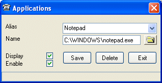

    The [Application] section
    [Application]
    # Application execution list
    A1=@C:\WINDOWS\notepad.exe,Notepad
    A2=C:\WINDOWS\cmd.exe,Command
    A3=C:\Program Files\Winamp\winamp.exe,Winamp
    A4=@C:\Program Files\MP3Gain\MP3GainGUI.exe,MP3 Gain
    A5=@C:\Program Files\Winamp\winamp.exe "c:\my music\allmp3.m3u",Winamp2
    A6=C:\WINDOWS\Media\town.mid,MIDI
    A7=C:\MyMusic\Pink Floyd - Bring The Boys Back Home.mp3,PlayMIDI
    A8=</END>
    # You can define an unlimited number of applications (scripts), sounds files (wav, mid or mp3) to be executed when a specific call is received. The file is represented using the full path. The "@" character specify that the respective file is executed with display interaction. If it is missing, then the file is executed in background. For each file a friendly name is defined.
    This filed is edited through the graphical interface (Config Application Menu). The section has an end delimiter (</END>).
    The [Monitoring] section
    [Monitoring]
    # Monitored events list
    M1=1&301,Application&Notepad
    M2=-&320,Application&MP3 Gain
    M3=2&*,X10&Living corner&On
    M4=-&304,Application&Command
    M5=309,Application&Winamp2
    M6=321,Application&MIDI
    M7=322,Application&PlayMIDI
    M8=</END>
    # You can define an unlimited number of monitored events. Each of them is represented by the DTMF&CallerID (number), the output device (X10 or Application), the sub-device (only for X10) and the friendly name of the command, as defined in the specific section. The section has an end delimiter (</END).
    The '-' for DTMF means that only the CallerID is considered for that event. A '*' character for CallerID means that any call will be automatically answered and the command executed only based on DTMF.

    Using the GSM/PSTN Gateway feature
    Starting with the version 0.9.15a, a new important feature has been added. You can now use DIAX as a remote PSTN/GSM/PCS/DCS/CDMA line for an Asterisk server. This functionality has been tested on Ericsson/SonyEricsson phones only. Some features (like CallerID for the incoming calls) will not be available on other phones. Standard voice modems can be used too, but this has not been tested yet. Extended phones/voice modems support will be available in the next releases.
    In order to use this feature you must configure DIAX and then the extensions.conf and iax.conf files on the Asterisk server.
    Let's do it step by step.

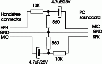

    1. Build the audio cable
    In the current version the audio path through Bluetooth is not available. You must use a cable to connect toe GSM phone to the PC.
    The cable can be build using a very cheap handsfree kit. Just disconnect the microphone and the headphone and connect two 3.5mm stereo jacks.
    In order to adapt the audio levels you must build and insert two attenuators, like in the following picture:
    The cable from the old microphone must be connected to the soundcard SPK output and the one from the old headphone to the soundcard MIC input.
    2. Activate the Bluetooth/serial connection to the phone
    Go to the Using Bluetooth to control DIAX chapter to see how to configure the COM port for the Bluetooth serial connection. If you want to use a serial cable, then select here the COM port used to connect the phone or the COM port of the voice modem, as appropriate.
    Select the GW checkbox to activate the GSM gateway functionality. When this feature is activated, the DIAX phone keypad becomes inactive.

    Defining Applications to be executed
    From the Config menu you can access Application Configuration
    In this form you can define application/scripts/sound files to be executed/played when in monitoring mode and one specific event has been triggered.
    To enable Application execution when a monitored event is triggered, check "Enable".

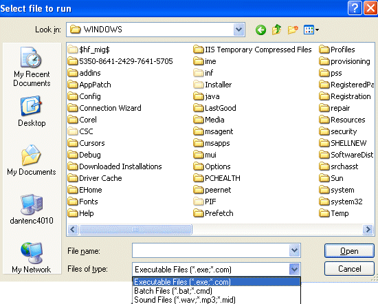

    Enter a name (alias) for the application/sound and then click on the small folder button to browse the filesystem for the file to be executed/played.
    You can select Executable Files (exe or com extensions), Batch Files (bat and cmd extensions) or Sound files (wav, mp3 or mid extensions). After you browse and select the file, click on Open. The full path and the file name is entered in the "Name" textbox. You can then enter a friendly name for that file in the "Alias" field and select if you want or not to interact with desktop by selecting or not "Display" checkbox. When you finish, click on "Save" button to save that entry in the configuration file.
    You can delete an already defined application by selecting it from the list and clicking on "Delete" button. Take care that there is no warning before deleting it.

    Using the Monitoring function
    From the Config menu you can access To Monitor menu.
    To define a new monitored event, you have multiple options:
        - select a DTMF digit, and nothing for the CallerID. In this way the phone automatically answer for any call and waits for a specific DTMF digit to be received in order to trigger an event;
        - enter both a DTMF digit and a CallerID (number). In this way, the phone answer a call if it is from that specific CallerID and waits for that DTMF digit before triggering the event;
        - select '-' (ANY) as DTMF digit and enter a CallerID. In this way the event is triggered by the CallerID only and the phone answer the call only if Autoanswer is defined for that call or unattended. You can in this way execute commands without even answering the call.
    Using those features, you can have an unlimited number of commands from the same remote phone keypad.
    Then select from the list one of the already defined X10 device or Application and the desired command to be executed. The command list is filled automatically accordingly with the selected device.
    Then you must click on "Add" button to save the event in the configuration file.
    When you finish all events definitions, you click on "Exit" to return to the main application window.
    To delete an event, just select it from the 'Available monitored events" list and click on "Delete" button.
    From time to time, after you have deleted some of the X10 devices or applications from the configuration file, you must used the cleaning functionality ("Clean" button) to delete orphaned monitored events (ones with no more existing defined devices).
