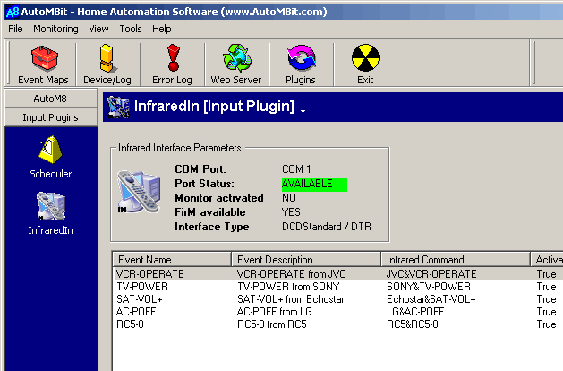

The main window of the plugin is almost the same for both of them, including the list of the defined events and the COM port status. For the input plugin you get the monitoring status too.

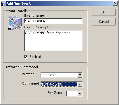

The form used to add a new event is common for both plugins. You can select from the list of available protocols, then commands. By default the Event Name is filled with the name of the chosen command and the Event Description with the name of the command "from" Name of the protocol, but they can be edited afterwards.
By default the event is enabled, but can be disabled with a simple click. When everything is ok, click on OK.
Zone number listbox is available only if the FirM interface is selected in the configuration window.

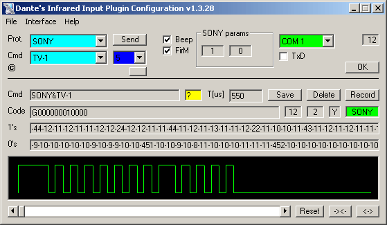

The configuration window for the input plugin is based on the full functionality of the IRM standalone application. Click here for a complete description and the online help.
There are only small differences: the existence of the OK button used to return to the AutoM8it framework and the FileExit menu is missing.
You cannot exit directly from the configuration window, you have to close the main AutoM8it application.

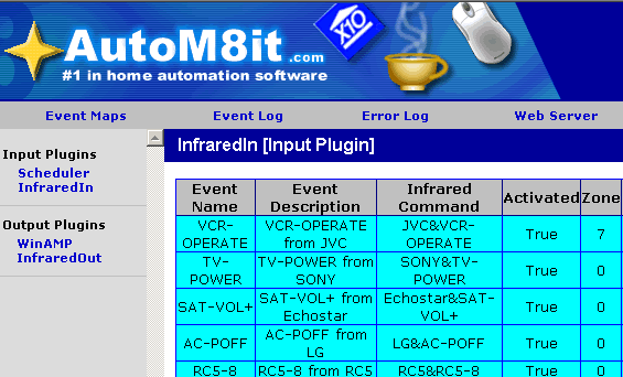

The web interface for the input plugin only display the list of the defined input events.

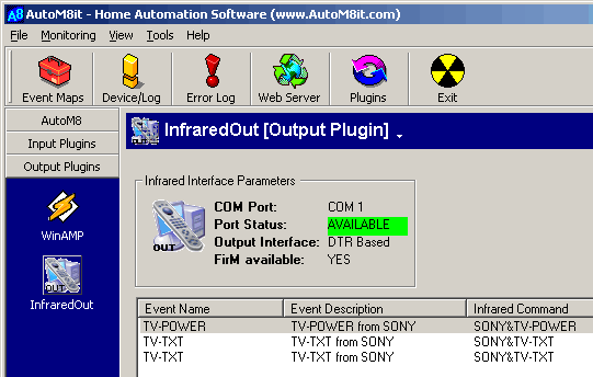

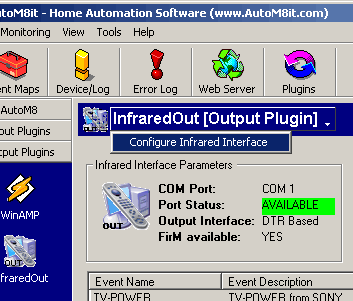

To configure the infrared hardware interface (COM port and output type) you must click on the InfraredOut [Output Plugin] bar.
Then you will get the following configuration wiindow for the output plugin:
You can choose the right COM port (only from the available ones) and the interface type (DTR based or TxD based).
If FirM interface is available, check the small box. Then the TxD radio button will be disabled, because TxD based send interface and FirM cannot work on the same COM port.
The main plugin isplay is automatically refreshed after the configuration changes
If for some reason the selected port cannot be used, in Port Status line the message will be "UNAVAILABLE", with a red background.
You can now start to define output events from the AutoM8it framework. See AutoM8it Manual for details.
